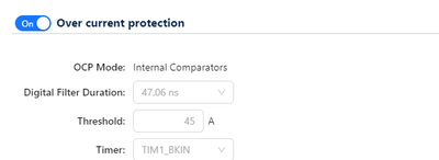

I am using custom board and MCSDK 6.4.0, I need some clarity on the Application current and the overcurrent protection variables
The above setting is related to the Max application current.
And the over current protection settings in MCSDK is as below
Here it is mentioned as 45A. Now my question is do i need to change this value and how this is related with the 1.6A max application current? I am using FOC to run the motor.
GMA
Hello @STuser2,
"Max. application Current" is related to Motor "Max current" value.
OCP threshold value is related to Power Board (or inverter power part) "Rated Current" value.
