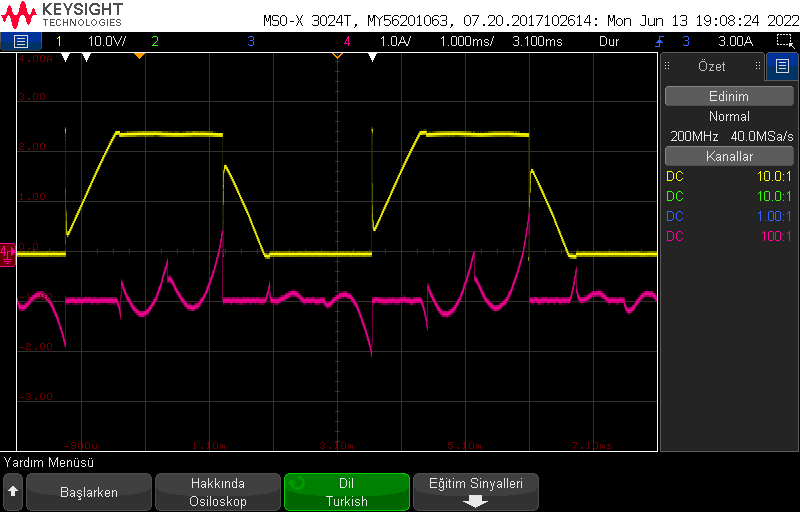

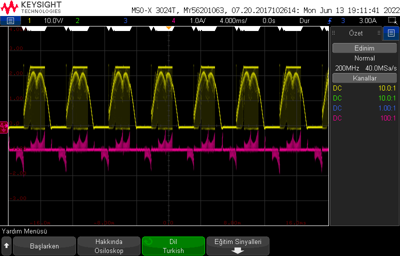

Hello There,
I am currently work on 6 - Step (Trapezoidal) Control and have developed my software with Nucleo - F302R8. I have a low inductance(23uH) bldc motor. When I've tested this motor with my software, current signal doesn't look right. Also, we have tested bldc motor with another motor driver and signal is same.
What can be the reason of this signal?
Yellow -> Dc_Bus - Phase
Purple -> Phase Current
PWM at 100% duty cycle

from the waveforms there seems to be a problem of loss of motor synchronism.
Could you share more details on your application?
Are you using a custom board and/or custom firmware?
Is the 6-step control sensored or sensorless?
Have you checked the waveforms of current and voltages of each motor phase?
