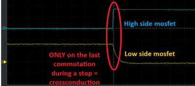

Hello everyone,
I'm working on a motor control project using an STM32 microcontroller (TIM1 and TIM8 timers), and I need to implement a soft Break to safely stop the PWM signals with proper transitions (respecting Dead Time and setting the outputs to 0V in low-impedance mode). However, the methods I've tried so far don't seem to work as expected. Here's what I want to achieve:
  1. When stopping the motor, ensure all PWM outputs go to 0V in low-impedance mode.
  2. Respect the configured Dead Time during the transition to avoid cross-conduction.
  3. Optionally, use a software-triggered Break (TIM_BDTR_BKE) to achieve this cleanly.

Observed Issues
  1. Activating TIM_BDTR_BKE does not seem to have any effect; the PWM outputs continue to run as if nothing happened.
  2. OSSI/OSSR do not seem to control the state of the outputs when the timer is off or after attempting the Break.
  3. Using HAL_TIM_PWM_Stop does stop the PWM channels, but it doesn't ensure transitions with Dead Time, which risks cross-conduction in my H-bridge.

simon_EQUIUM
Ok, I have found the solution.
To stop the motor by software you have to use the lines :
htim1.Instance->EGR |= TIM_EGR_BG;
And to restart the motor :
	    htim1.Instance->BDTR &= ~TIM_BDTR_MOE;
	    status |= HAL_TIM_PWM_Start(&htim1, TIM_CHANNEL_1);
	    status |= HAL_TIM_PWM_Start(&htim1, TIM_CHANNEL_2);
	    osDelay(1);
	    status |= HAL_TIMEx_PWMN_Start(&htim1, TIM_CHANNEL_1);
	    status |= HAL_TIMEx_PWMN_Start(&htim1, TIM_CHANNEL_2);
	    htim1.Instance->BDTR |= TIM_BDTR_MOE;
I don't know why, but I have to place a osDelay before PWMN because I want to active in a first time the low side of my channel. Without this delay, the high side start before the low side and the bootstrap capacitor can't be charged.
