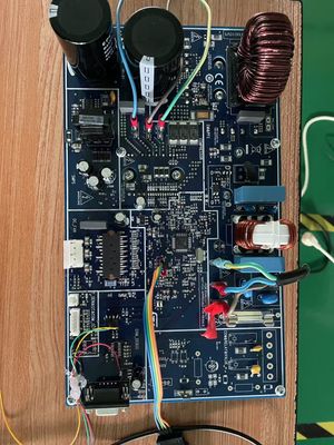

Why is the bus voltage remain  about 330v when motor max-voltage is changed to 280v ?
the attchment is the status of Motor Pilot based on STEVAL-CTM010V1 .

Hello @wcx8229
When Bus voltage sensing is enabled as it is your case for Motor 1, the value is read from the board and does not depend on the motor max-voltage.
How is your board powered?
Regards
Cedric
Thanks for your support.
The power input is 220VAC 50HZ .
So could you tell me how can I get a 280v bus voltage ?

So steval_ctm0101v1 does not support 280V BLDC motor because of OVER VALTAGE ?
RobK1
Senior II
Just exactly how do you think this thing would be able to make a 280V bus voltage with a 220VAC input?
