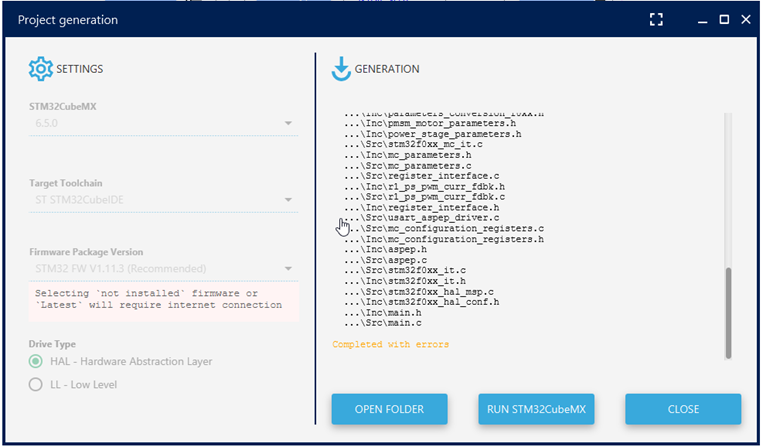

What do I choose as Drive Type option HAL or LL ??
Use LL according to some posts I read and push UPDATE
Here we are received Complete and then what should i do ???
You get OPEN FOLDER or RUN STM32CubeMX or Close

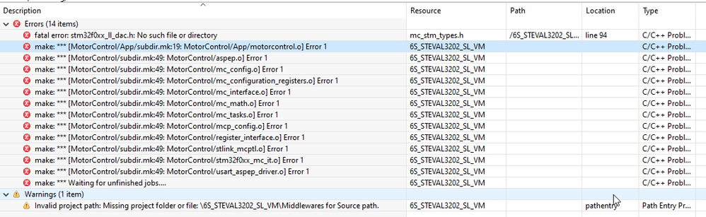

Push the Run Button and the we have :
A lot of errors ??? and a hugh amount of code .
Searched on my drive stm32f0xx_ll_dac.h" and found it ??
- D:\MotorTest\6S_STEVAL3202_SL_VM\Drivers\STM32F0xx_HAL_Driver\Inc
How can I solve the above errors ? or Handle I it completely wrong

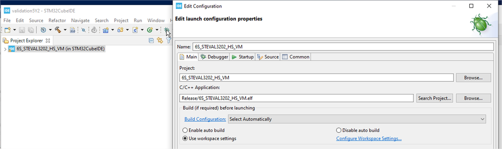

When you choose the example, a readme.txt pops up with some tips (as usage of IDE e.g).
Could you try by using STN32CubeMX: 6.5.0?
Once compiled, IDE will download directly .elf file:

Hello, download the 6.5.0 and tried again but unfortunately I get a bunch of errors see log file.

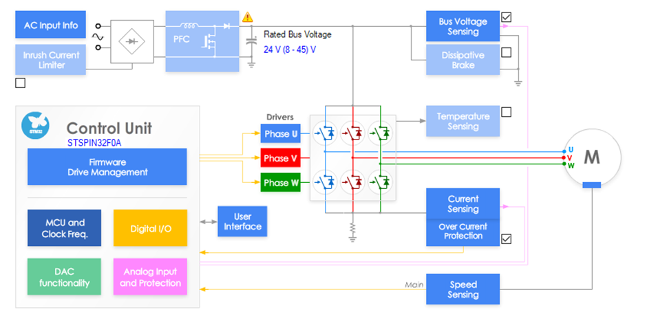

Also I saw although I selected Senserless and Voltage mode via STMCWB :
I see connection lines for the speed sensing :
But still I continued just to see If I can compile an download it.

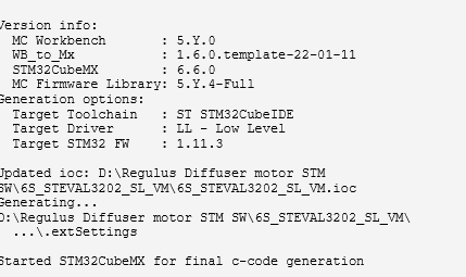

Hereby the log file after :
Of course I persist to complie it but of course also there errors:loudly_crying_face:
