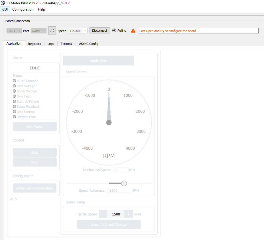

How to configure the board for experimenting in MotorPilot with STEVAL-SPIN3204?
The PC recognises the evaluation board and I followed the steps in the MotorPilot manual. But I always get warning - Port Open and try to configure the board.

Hello @KSpeh.1​ ,
What is your MCSDK version ?
Unfortunately we introduced a regression in the 5.Y.4 release concerning STM32F0 series using USART1 and USART3. (STSPIN32F0B is build on top of STM32F0)
Release 5.Y.3 is not affected and I suggest you to move to this version.
Regards
Cedric

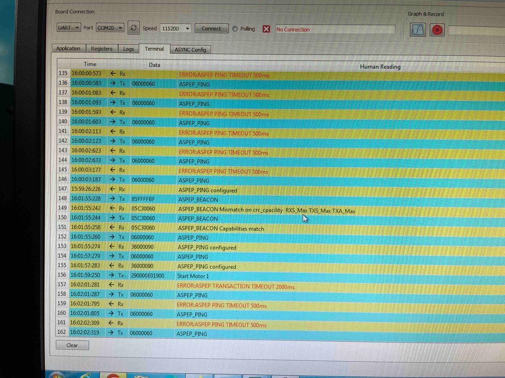

Nevertheless new problems arise: As soon as I want to send an instruction through ST motor PILOT, I get the message Port Open but no answer from board. I have to uncheck Polling in order toi have a stable connection otherwise the above error message is displayed and connection lost. Here is a screenshot of what happen when I send START command for example.
Best Regards
David

Exactly the same issue with a baud rate set to 1843200 in main.c and in motor control.
Just after connection established, I get in the terminal the message "ASPEP_BEACON Mismatch on crc_cpacility RXS_MAX TXS_Max TXA_Max" and connection is still alive.
As soon as I click on START button (for example, but it's the same results with all other button) I get the the error message ERROR: ASPEP TRAN?SACTION TIMEOUT 2000 ms and connection is lost.
Another idea?
Regards
David
PS: I cannot select this speed on the port parameter tab in the win driver section (max speed selectable is 128000). My driver is up to date.
