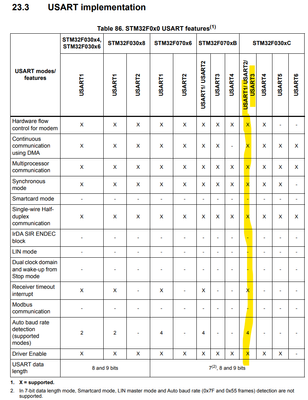

Amel NASRI
Hi @FSS1 ,
I can help answering the first question:
Is there any documented difference between USART1 (on STM32F030RCTX) and USART3 (on STM32F030CCTX) regarding auto-baudrate hardware behavior?
Based on the following table from the product reference manual RM0360, both USART1 and USART3 have the same features implementation:
-Amel
