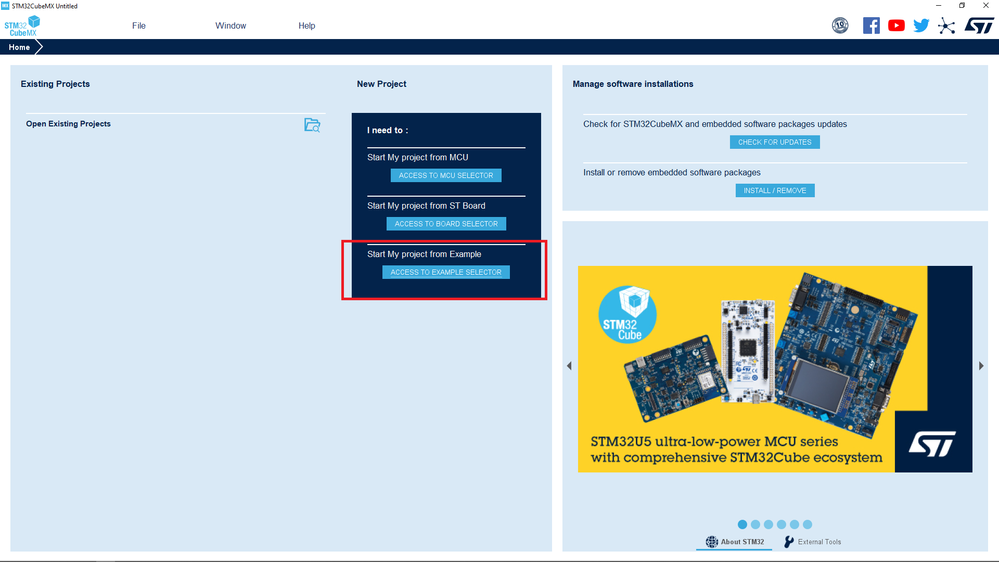

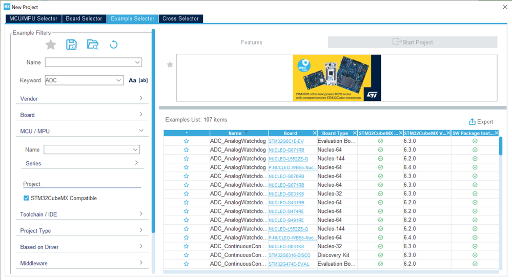

There are some ADC examples available under C:\Users\<Your_User_Name>\STM32Cube\Repository\STM32Cube_FW_XX_Vx.x.x\Projects. Some of these examples don't come with an .ioc file but they are helpful.
You can also find some examples under Example selector in CubeMX, some of which are Compatible with STM32CubeMX.
