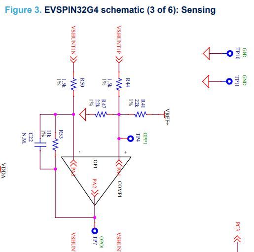

Going over the documentation for the EVSPIN32G4, this is the schematics for current sensing:

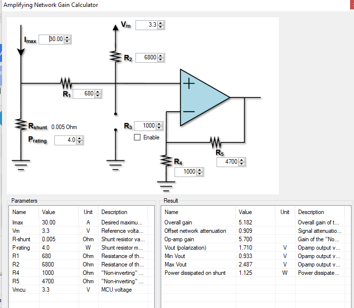

0693W00000JO2inQAD.jpgBut starting a project in Motor Control Workbench for this board, seems to have different values for the same schematics:
0693W00000JO2iTQAT.pngAm I missing something? Why the discrepancy?
PCama.1
Oh, never mind, I just realized that I was looking at the setting for an external network gain, not at the embedded over current protection topology protection gain. Mystery solved!
