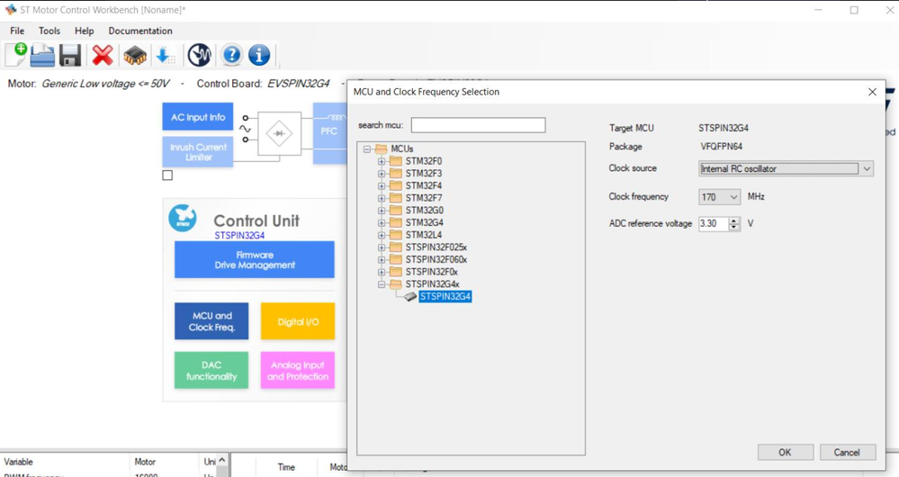

Hello Cristina,
I have crated the custom ESC board based on a schematic of EVSPIN32G4.
I generated the software fo the STSPIN32G4 in ST Motor Control Workbench and flashed it.
The board does not work with that software. The behaviour I did already described in one another my question from yesterday.
So, my idea is to get the flash image (the hex file) of the EVSPIN32G4 board and to flash it on my board. So, I need the hex file of the EVSPIN32G4, means, the same software that is used in an original EVSPIN32G4 demo boards.

Hi @HAL-9000​,
the EVSPIN32G4 evaluation boards come with a clean flash.
From your other post I noted that you do not have the external crystal mounted on the board.
Did you set the use of the internal oscillator?
You can set it clicking on the Control Unit in the MCU and Clock Frequency Selection:
Let me know if this solve your issue.
‎2021-06-18 2:44 AM
The picture is not the finally build board. In the final all the components are already in place, also the oscillator.
Of course, I did already try setting the internal and external oscillator in both MCSDK and in the STM32CubeMX. This does not help.
As mentioned, the same behaviour of the software generated by MCSDK I have not only on my STSPIN32G4 (built for EVSPIN32G4) but also on the NUCLEO-G431RB (built for B-G431B-ESC1).
It seems to me to be some general problem for G4 based software builds, because the other builds for other MCUs work fine for me (for example F3 and F4 builds for my X-NUCLEO-IHM06A1 and X-NUCLEO-IHM07M1).
