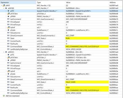

this is a screenShot of the handler of the 2 motors
as you can see the state of the first motor is RUN, and the other is FAULT_OVER
with pastFaults code 1024 and some times both dont start
edit : i found out that theose error linked to dirver protecttion and overcurrent

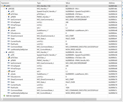

i fixed them , now i am getting the FOC duration Fault, with the same problem one motor turn the other try to run for a second , then one of them just stop with FOC duration Fault.

GMA
In case of FOC duration fault, please decrease the PWN Generation Frequency or increase Current sensing regulator execution time to give more time to MCU to process FOC.
If you agree with the answer, please accept it by clicking on 'Accept as solution'.
