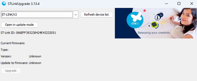

Using MCSDK 6.4.0 EVSPIN32G4 example (EVSPIN32G4_Shinano.stwb6), generating the code with STM32CubeMX 6.14.1 or 6.15.0 and FW Package 1.6.1, I am able to compile with no error the project with STM32CubeIDE.
Using STM32CubeIDE 1.18.1, I had a message for updating ST-LINK. After firstly "Refresh device list", and "Open in update mode", I upgraded ST-LINK.
After ST-LINK update, I am able to flash the board and launch the FW with STM32CubeIDE.
Loading EVSPIN32G4_Shinano.ioc file on STM32CubeMx 6.14.1, STM32G431VBTx MCU with LQFP100 mention is display as expected, as it is the MCU embedded inside STSPIN32G4 system-in-package.

Hello @Cedd,
