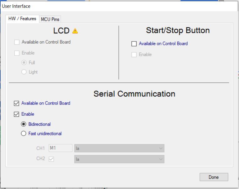

> Any idea why the GUI won't connect to the 1V1 after flashing it with the IDE?
If you are able to profile your motor with this board, your hardware setup is obviously OK.
If you started from the example, I do not see a obvious reason that could explain your issue.
There is few things you can check in order to debug your UART issue.
- Check that the UART is properly enabled in the User Interface box.
- Check that the UART is well configured in th Digital I/O box
If both are OK, you need to dive into the code.
First thing you can do is to put a break point on USART_IRQHandler from the file stm32_F3XX_mc_it.c
It should break as soon as you try to connect with your PC. If it is not the case, you need to check why. Possible root cause are :
- USART interrupt not enable at NVIC level.
- USART RX interrupt not enable at USART level ( RX UART is first enable by UI_TaskInit calling from MX_MotorControl_Init )
- USART is not correclty configured (IP number or Pins)
> 2. Related to this suggested user code for “stm32f0xx_mc_it.c�?, there is no /* USER CODE END START_STOP_BTN */ i
This is because the button is not selected in the User interface

"Check that the UART is properly enabled in the User Interface box." I made no changes to these parameters for the sample, so it's as delivered. Does it seem correct to you?
"Check that the UART is well configured in the Digital I/O box". I made no changes to these parameters for the sample, so it's as delivered. Does it seem correct to you?

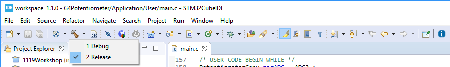

For the STEVAL-ESC001V1 issue, in STM32CubeIDE, you have to build your project in Release mode.
There is, as the image below, a contextual menu allowing you to choose between Debug or Release mode.
The correct optimization level is set in Release mode (Optimize for speed).
This menu is accessible through the little arrow at the right of the hammer.

This is not my issue currently. I always use "Release" because the generated code doesn't fit inside the available memory on some evaluation boards. My current issues are listed in my most recent post of 4 days ago. Hopefully you can help with those issues.
Thanks! David Cyr
