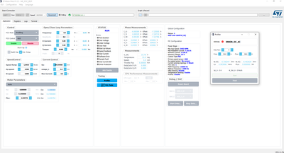

Thanks a lot for the help with the HSO_startup_guide.pdf file. I found this file and tried the workflow on page 9. However - when I click on profiler and start the process I receive an error: ERROR_DC_AC in the profiler window.
I attached a screenshot.
Can you please give me a suggestion what went wrong?
Best regards and many thanks
MoCo

I'm also getting the same error in the profiler: ERROR_AC_DC_CHECK
As per HSO_startup_guide.pdf I have tried increasing the power setting ('POW:') in the profiler window. as per the HSO_Startup_Guide.pdf, with no success.
I don't seem to seeing any signal on the Motor terminals and there is no change in load from the power supply.
Any suggestions?

This is a really strange behavior. Could you please switch to Open Loop Mode and see if any current is coming through ?
Also could you send me your .stwb6 project files ?

Hello again,
You can also try to disable the SCREF feature by adding a jumper to J1 on the STEVAL-LVLP01 power board. This is a voltage protection between the source and drain and it can cause the Profiler Error you are facing.
If you agree with my answer, please consider accepting it by clicking on 'Accept as solution'.

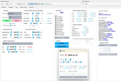

I also have this problem, but I didn't use STEVAL-LVLP01 . I designed a custom inverter, based on G473VE, external amplifier and compare, use TIM8 to generate PWM wave, use IR2101S to drive MOSFET. When I try to profile the motor(based on HSO), I get the error: ERROR_AC_DC.
I have upload the screenshot(90e0d582f6e2fb5d5043ff325aab241.png), stwb6 file(MCV1_HSO_PROFILE.rar) and schematic files(MC_V1.pdf). Could you help me please? Thanks a lot!

I will nonetheless try to answer your problem here. Can you try to profile with a lower power value ?

Thanks a lot it worked!
Adding the jumper for SCREF worked. I also had to increase the allowed current in the MCW.

Adding the jumper for SCREF also worked for me.
