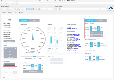

Hello @AlexPi,
It is possible to tune the speed proportional-integral (PI) regulator parameters in real time by using the MC Pilot interface:
If you agree with the answer, please accept it by clicking on 'Accept as solution'.

AlexPi
I've already tried adjusting the PI speed controller, but I didn't get the desired result. When adjusting these coefficients, I experienced either a faster or slower throttle response. Or, I experienced a decrease or increase in speed fluctuations around the target point. In my case, I experienced rotor position loss at high RPMs.
