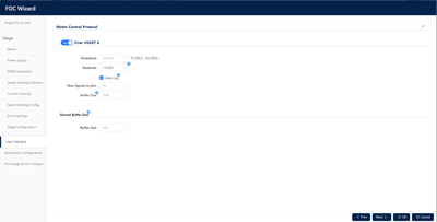

Hello Sujay,
The first step is to try to decrease the speed of the UART communication.
In the motor control workbench you can find a section "User interface", where you can modify the speed
Cables length matters, you should keep the cable as short as possible both USB and STlink connector. Also that the motor cable should be kept short and far from communication.
Consider also that the board has no EMI filter, because it strongly depends on the motor attached, Adding an EMI filter could help to reduce noise and improve robustness of the communication.
Francesco
sujay-s
Hi Francesco,
Thank you for your suggestions. We’ve resolved the Motor Pilot disconnection issue by using a 2-channel digital isolator between the EVAL kit and the USB-to-TTL converter. I’m now working on tuning the control parameters for the rev-up phase.
