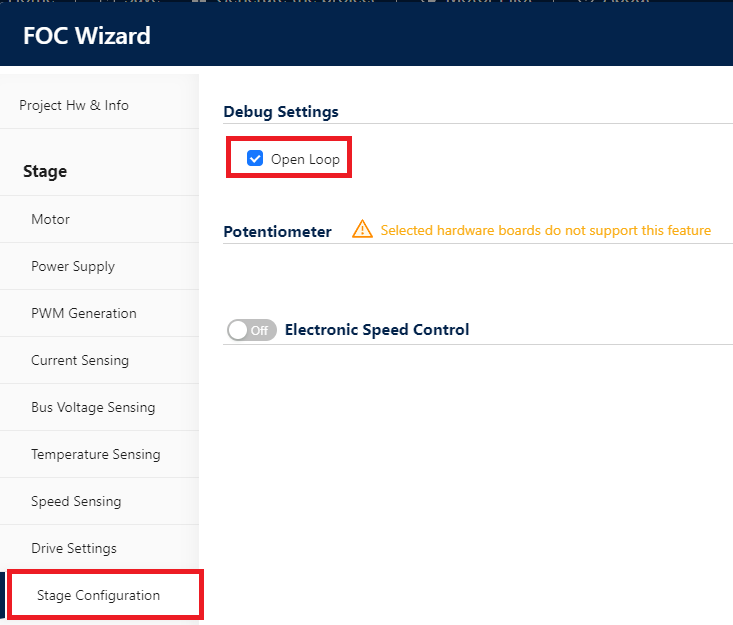

You can enable "Open loop" feature in your MC workbench project and regenerate it:

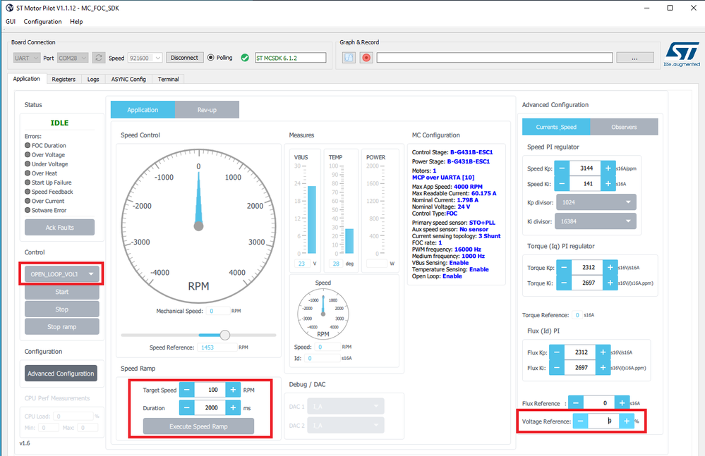

Then flash your firmware and select in MCPilot: OPEN_LOOP_VOLTAGE, set a voltage reference (few percent depending on your motor), and a speed ramp (few RPMs). Start the motor and check that the motor spins smoothly
The picture below shows an open loop voltage setting with B-G431-ESC1 board.

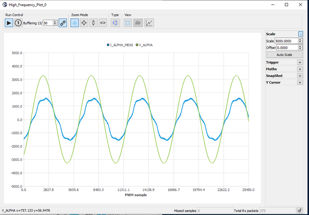

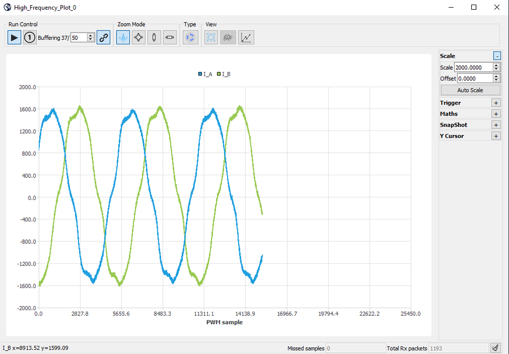

Then check the signals processed by the firmware like currents, voltage. the pictures below show the currents "read" by the ADCs.
currents.PNGYou can also compare the currents to the voltages like the picture below
current_vs_voltage.PNG This experiments will give you some hints on the current sampling.
