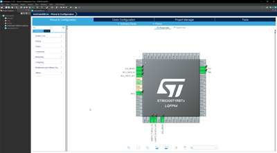

I seem to not fully understand the issue though. Since you are talking about enabling X-Cube-XXX, I assume you were on the STM32CubeMX that is embedded in the STM32CubeIDE software, so to me this is an STM32CubeMX question even if you are opening STM32CubeIDE. Perhaps we could clarify this.
For instance, here is a brand new STM32G071RB project created using STM32CubeIDE, but as I create the project, it embeds STM32CubeMX:
In this project, I am not able to enable X-CUBE-DISPLAY, but if I create a STM32G071RB project from STM32CubeMX, it is also not compatible with my version but it is compatible with older versions of STM32CubeMX that are available for download on the official webpage.
Also, have screenshots and maybe the project file could help us.
"whether or not ST intend to produce a version of X-CUBE-DISPLAY that is officially compatible with the latest version of STCubeIDE, as the current version isn't"
