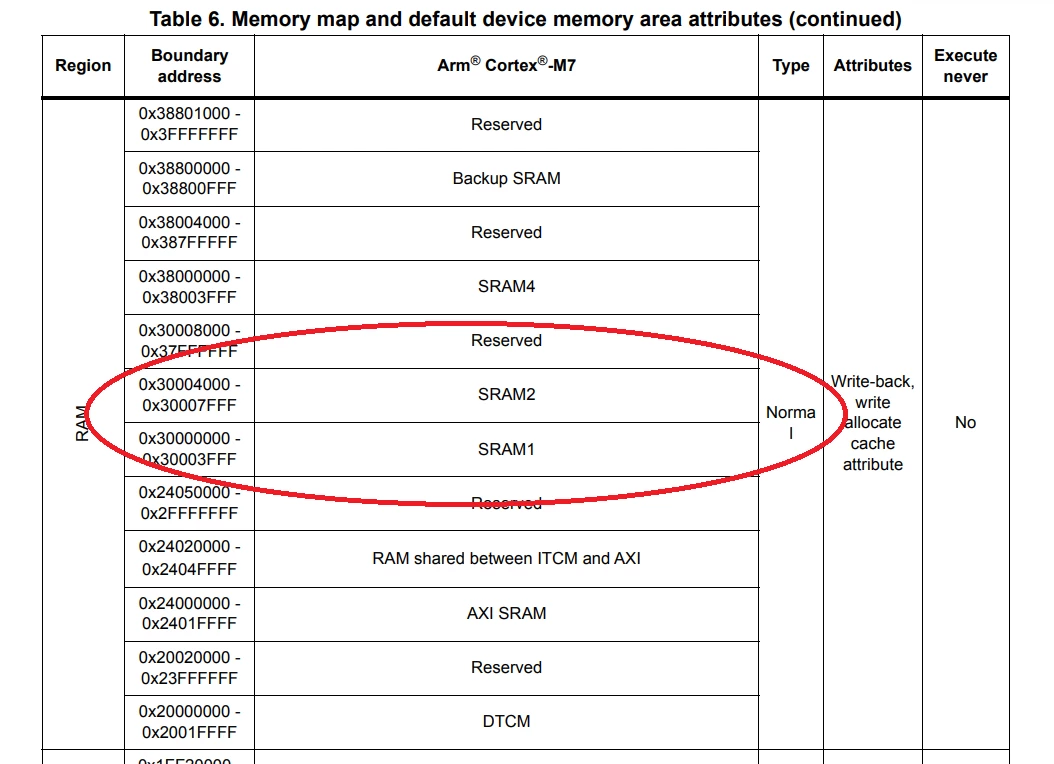

In LwIP examples for NUCLEO-H723ZG, in the linker, I think that there is an incorrect range of RAM_D2 memory.
For example here:
MEMORY
  ITCMRAM    (xrw)    : ORIGIN = 0x00000000,   LENGTH = 64K
  RAM    (xrw)    : ORIGIN = 0x20000000,   LENGTH = 128K
  ROM    (rx)    : ORIGIN = 0x08000000,   LENGTH = 1024K
  RAM_D2 (xrw)      : ORIGIN = 0x30000000, LENGTH = 288K
SRAM available from 0x30000000 has 32 kB available
from  the reference manual:
Or am I missing something? I am writing here before creating an issue on GitHub as I am not sure I am not misreading something. I think they took it from the STM32H74x/H75x devices as those have this amount of memory.
The example works correctly as the addresses used are hard-coded in the application, but the size should be correct either way.

You are correct, the RAM size of SRAM1 & SRAM2 in D2 is 16kB each.
There are many errors in many ST files, probably the typical copy & paste.
BTW, in the H723 - H735 series, ethernet DMA can access AXI RAM, although use of descriptors (and maybe some RX/TX buffers if space allows) in D2 = SRAM1 & SRAM2 is preferred, as the ethernet MAC also resides in D2. (See block diagram RM0468, page 107)

Hi @heveskar ,
RAM_D2 size issue is fixed in GitHub.
Thank you for your contribution in STCommunity.
