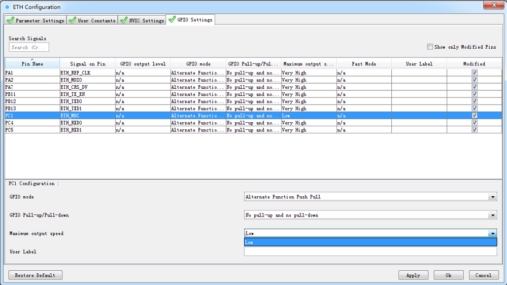

Hi all:
I using cubemx to config stm32h743 eth, why pc1 can not set output speed to very high, the pc1 can only select low, not like other pins.
Thanks.

Doesn't MDC clock at 2.5 MHz max, what would be the value of aggressively slewing it other than generating unnecessary ringing and noise?

Thanks Clive Two.Zero.
