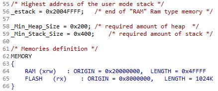

How would I store data to RAM and be able to recover it? Can you suggest a safe address for my application? This is the RAM allocation as defined in the linker file for both the bootloader and the application. Obviously the flash addresses are different. Do I allocate (aka "carve out") more memory?

Since the application is using the RTC peripheral, I am trying to get the RAM approach working first. However, it isn't saving the data.
Application Code:
uint8_t *ToReprogram = (uint8_t *)0x2004FFFF; // last byte of allocated RAM
PRINTF("ToReprogram: %d\n\r", *ToReprogram); // ToReprogram == 97
*ToReprogram = 1;
PRINTF("ToReprogram: %d\n\r", *ToReprogram); // ToReprogram == 1
NVIC_SystemReset(); // software reset -> Jump back to bootloader for reprogramming
Bootloader Code:
What am I missing?
Never mind. I took your advice from the following post and it fixed the issue.
https://community.st.com/s/question/0D50X00009hmvGZSAY/help-storing-a-variable-in-ram-that-does-not-get-initialized-at-startup-for-watchdog-recovery

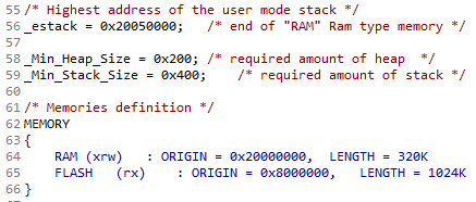

Specifically, I updated my linker file as such:
And does this work? The stack pointer must be aligned at least on 4 bytes.
It does work, but now that you say that I better do that so that I don't run the risk of overwriting whatever is in front of it. Thanks!
