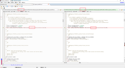

The serial port 1 code generated by the latest STM32CubeMX 6.13.0 will print garbled characters, and using the serial port routine UART_Printf in STM32Cube_FW_H7_V1.12.0 will also print garbled characters.
It doesn't work when using the serial port routine UART_Printf in STM32Cube_FW_H7_V1.11.2. After comparison, there is a difference here. I can’t understand the function here. I will be careful whether changing it will affect other functions.

Hello @zhengjianxing,
Thank you for bringing this issue to our attention.
const uint8_t D1CorePrescTable[16] = {0, 0, 0, 0, 0, 0, 0, 0, 1, 2, 3, 4, 6, 7, 8, 9};
should be
const uint8_t D1CorePrescTable[16] = {0, 0, 0, 0, 1, 2, 3, 4, 1, 2, 3, 4, 6, 7, 8, 9}
I reported this issue internally.
Thank you for your contribution to the community.
Internal ticket number: 197431 (This is an internal tracking number and is not accessible or usable by customers).
Thank you.

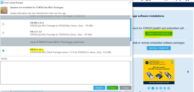

This issue is fixed in STM32Cube_FW_H7_V1.12.1 version.
Could you try to update the STM32CubeH7 and let me know if the issue is solved or not?
You can use STM32CubeMX 6.13.0 to update STM32CubeH7.
Thank you.
Kaouthar

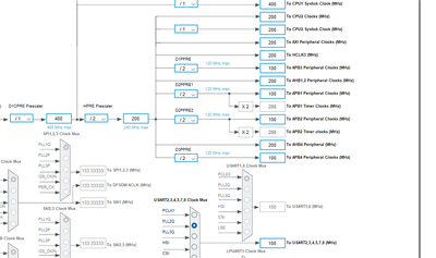

Nov 7, 2025 10:50 AM UTC
we observed the same problem with the UART baudrate when using APB Peripheral Clock.
Our setup was:
SYSCLK = 400 MHz, HCLK = 200MHz, APB1-PERCLK / 2 = 100MHz and APB2-PERCLK / 2 = 100MHz.
The configured and expected baudrate was 115200. Instead, we measured 57200 and the communication obviously wasn't working with 115200 baud.
Changing the dividers D2PPRE1 and D2PPRE2 to 1 (instead of 2) led to measured 115200 baud and the communication worked. However, the CubeMX.6.13.0 would not let us do the change as APB-PERCLK would be 200Mhz which is  > 120MHz limit. We made the change directly in the code.
We now wonder whether this 'workaround' creates problems, i.e. noise, inside the STM32H7 - as the changed devider setup now apparently uses 200MHz as APB1/2 PERCLK ?!
The change to  STM32Cube_FW_H7_V1.12.1 did not help. The problem is still there!
Deriving the UART CLK from PLL2 instead works well.
Have there been any further attempts to find the bug?
