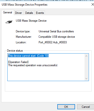

I have STM32L4 based board NUCLEO-L476RG
I have initialised it USB Device Only Mode with Mass Storage Class IP and a microSD Card interfaced on SDIO (1-bit) and from CubeMX.
I am using MSI RC at 48MHz to clock USB.
STM32Cube_FW_L4_V1.8.1\Projects\STM32L476G_EVAL\Applications\USB_Device\MSC_Standalone.
Based on this example, I have made all the necessary modification in usbd_storage_if.c file.
I am able to get the USB enumerated on the PC when I connect the USB cable, the device appears in Unspecified category.
No new removable drive appears in the system window.

You'd likely need to instrument the USB interactions, and at the SCSI/ATAPI command processing level. Use the serial port or SWV so as not to interfere with the real-time operation.

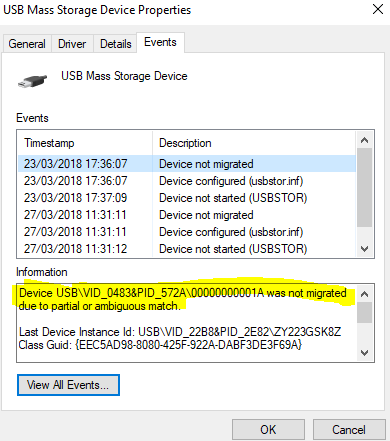

I have an another board stm32f4-discovery, I ported the above code to it and this is what I get
‎2018-03-27 4:41 AM

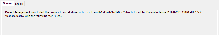

On further looking for information this is what I got

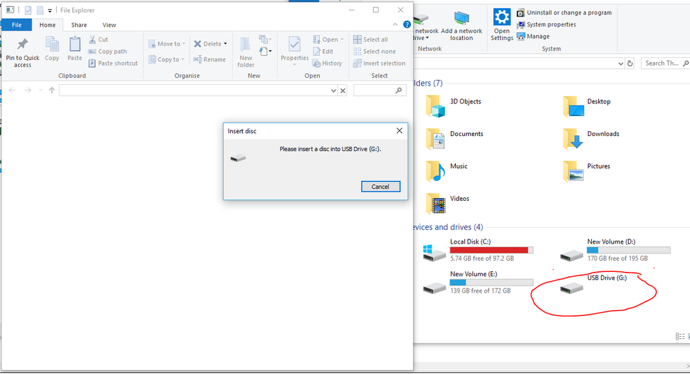

Update :
After plugin the usb, and I am powering through USB VBUS I get a popup and I can see the removable drive in file explorer but it's not able to detect or access it
Any suggestions or help?

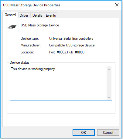

‎2018-03-30 3:00 AM
Update :
I am able to copy and delete files but can't write something.
Any suggestions?
