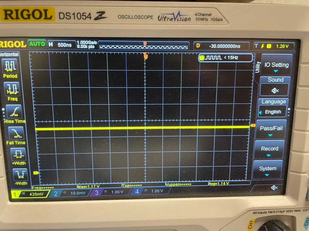

2021-04-07 5:50 AM
Mine's more of a tesseract than a cube..
2021-04-07 6:04 AM
Well here's another measurement. Looks a lot better I guess :)
Will test if the MCU boots in about an hour.
But thanks so far!
2021-04-07 6:51 AM
Did you check that at least something is working?
Debug it and ensure that the mcu is actually running.

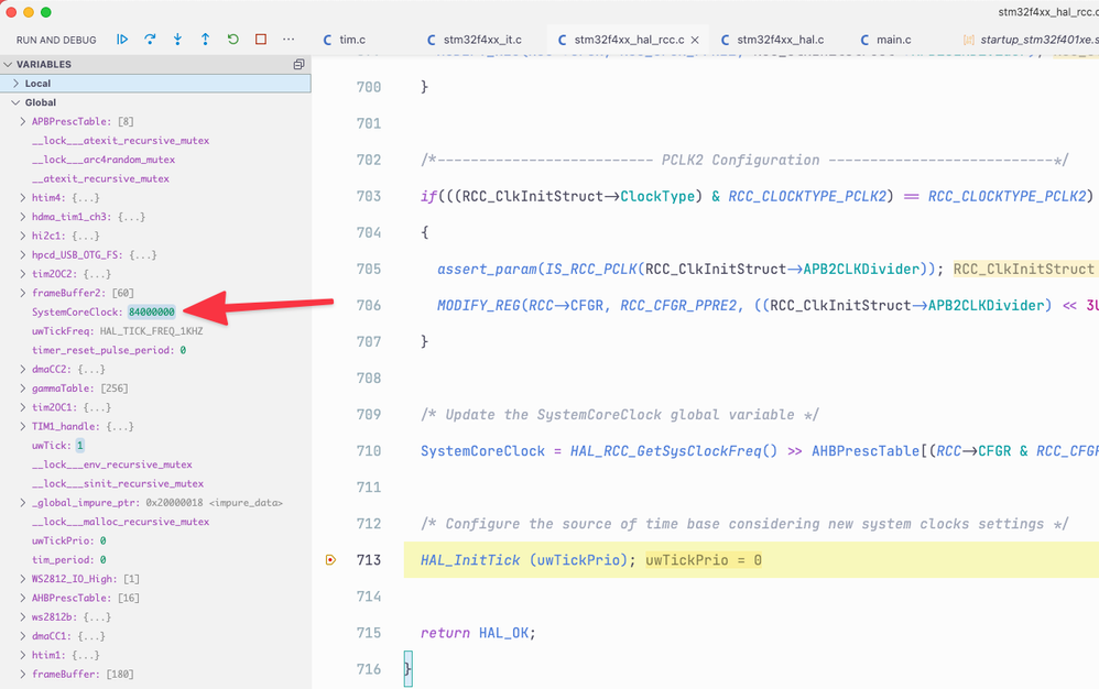

2021-04-07 7:24 AM
Guys. It works! :party_popper:
The problem was that I took the wrong cap value for VCAP.
I took 2.2nF instead of 4.7uF.
Now, there is no problem anymore with having a SYSCLK of 84 MHz.
Thanks for the heads up @Community member
You made my day :waving_hand:
