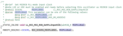

Wow, they really make this one confusing. There is no PLL on this chip like the ones on other families with customizable PLL multipliers and dividers. The clock tree accurately reflects this. Seems if you have 16 MHz crystal, it will auto calibrate per the reference manual.
Here's the bit you need to set:
Doesn't seem to be a way to do that in CubeMX. Not everything is clickable. Might need to add this yourself.
Edit:
Here's an example which uses LSE as the input/sync. Modify that to use HSE instead:
STM32CubeU3/Projects/NUCLEO-U385RG-Q/Applications/USBX/Ux_Host_HID/Core/Src/main.c at a88e56ca9916e3f93679559ecd9b17dc9e7a7a80 · STMicroelectronics/STM32CubeU3
