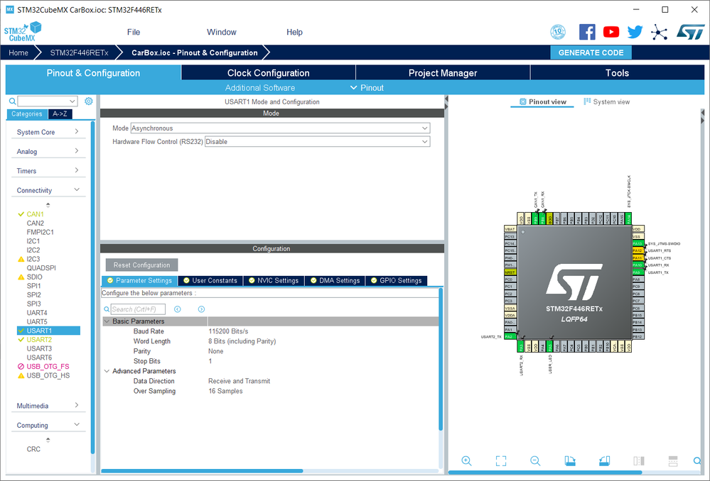

Thanks Bob for pointing out the misnomer! this solved my problem :) I'm on version 5.6.1 and it is still named "DMA on RX Error" Set it to disabled and all good now!
‎2020-07-16 5:10 AM
Can you advice me, where I should look for this setting?
In CubeMX 5.6.1 I'm not able to see any parameter like that...
‎2020-07-16 5:30 AM
‎2020-07-16 7:37 AM
2 things:
(1) Yeah, this feature would appear under "Advanced Features" in the "Parameter Settings" if your CPU supports it.
(2) Turns out my original answer was only partially correct. The CubeMX "DMA on RX Error" setting only controls whether the UART/USART CR3 "DDRE" bit gets set (in CPUs that support it). There is ALSO code in the "stm32XXXX_hal_uart.c" that, totally separate from the DDRE support, will abort DMA RX when it detects a framing/overrun/etc. error. I had to go disable/modiify sections of that code to keep RX going and just ignore the garbled data. At least in the STM32L4xx and G4xxx HAL code. Look for code that references UART_DMAAbortOnError (again, at least in the L4xx and G4xx HAL code).
