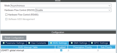

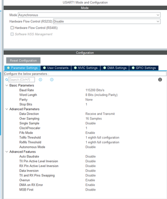

I'm trying trying to setup an interrupt receive on the U5 MCU using the STM32U5GJ-DK2 development kit. The USART1_IRQHandler does not get triggered at all. Here's my CubeMX config for the USART1:
I've sniffed the RX line, so I'm sure it's working as expected.

I realize that, most of this code is for debug purposes. However my problem here is that the RXNE interrupt, which I have explicitly enabled, does not get triggered.

What is the value of RxBuffer_Size? Does your UART is receiving the same amount of data?
Dobrev
RXBuffer is 20. I've tried with 10 and a whole bunch of different values. I've also measured the data with a logic analyzer to ensure consistency. The interrupt RXNE, which should get triggered when the FIFO is not empty, simply doesn't get triggered.
