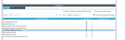

I am using a STM32C031G6U6 and I would appreciate some clarification regarding HAL timebase and SysTick timebase selection.
I want to use SysTick as a 1ms interrupt so in CubeMX I selected SysTick as timebase (see screenshot):

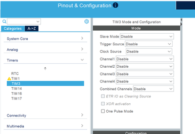

None of the other timers - including TIM3 - are not enabled as shown here:
These are the other settings:
I then generated the code.
But there is no sign of any SysTick related functions/handlers in the interrupt file stm32c0xx_it.c as you can see here:

On the other hand it does seem that TIM3 is somehow used/generated in the generated code in the file stm32c0xx_hal_timebase_tim_template.c (see below).

What is happening? Am I looking in the wrong file?
Where is the SysTick handler in which I can plug my custom functions that I need to run every 1ms?
Thank you

2026-02-05 11:57 PM
I've just generated a code with CubeMx based on STM32C031G6U6 and the interrupt is located in stm32c0xx_it.c:
/* Cortex Processor Interruption and Exception Handlers */
* @brief This function handles Non maskable interrupt.
void NMI_Handler(void)
/* USER CODE BEGIN NonMaskableInt_IRQn 0 */
/* USER CODE END NonMaskableInt_IRQn 0 */
/* USER CODE BEGIN NonMaskableInt_IRQn 1 */
while (1)
/* USER CODE END NonMaskableInt_IRQn 1 */
* @brief This function handles Hard fault interrupt.
void HardFault_Handler(void)
/* USER CODE BEGIN HardFault_IRQn 0 */
/* USER CODE END HardFault_IRQn 0 */
while (1)
/* USER CODE BEGIN W1_HardFault_IRQn 0 */
/* USER CODE END W1_HardFault_IRQn 0 */
* @brief This function handles System service call via SWI instruction.
void SVC_Handler(void)
/* USER CODE BEGIN SVC_IRQn 0 */
/* USER CODE END SVC_IRQn 0 */
/* USER CODE BEGIN SVC_IRQn 1 */
/* USER CODE END SVC_IRQn 1 */
* @brief This function handles Pendable request for system service.
void PendSV_Handler(void)
/* USER CODE BEGIN PendSV_IRQn 0 */
/* USER CODE END PendSV_IRQn 0 */
/* USER CODE BEGIN PendSV_IRQn 1 */
/* USER CODE END PendSV_IRQn 1 */
* @brief This function handles System tick timer.
void SysTick_Handler(void)
/* USER CODE BEGIN SysTick_IRQn 0 */
/* USER CODE END SysTick_IRQn 0 */
HAL_IncTick();
/* USER CODE BEGIN SysTick_IRQn 1 */
/* USER CODE END SysTick_IRQn 1 */
When using Systick is used as time base for the HAL, the configuration is stm32c0xx_hal.c.
So what CubeMx version are you using? and could you please share your ioc file?
