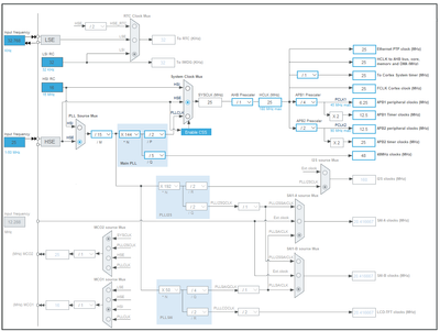

I want to creater a telnet server but can't even get the board to respond to a ping. I followed the following sequence:
  1. Crearted a new project
  2. selected my Nucleo-F439ZI board
  3. selected to initialize the peripherals to their default mode
  4. Got the following clock config (note I changed the HSE to 25MHz):debug_1-1711042245301.png
  5. Enabled FreeRTOS CMSIS_V
  6. Changed Timebase Source to TIM14 (in SYS config)
  7. Enabled USE_NEWLIB_REENTRANT (In FREERTOS config)
  8. Confirmed that ETH is enabled with RMII & confirmed all the pins are routed correctly (no changes needed)
  9. Enabled LWIP
  10. Changed the Driver_PHY to LAN8742
  11. Disabled DHCP
  12. Set IP to 192.168.000.123 with 255.255.255.0 as subnet
  13. Ctrl+s to create the sources!
  14. compiled & loaded the application & tried to ping the above IP (.123) from my laptop (set to 192.168.0.111) but do not get any response.
  15. I realized that it appears to get stuck in MX_LWIP_Init(). Why is this and how can I fix it?

Hello @debug,
as a first guess I recommend that you check the Tim14 Timebase is working as well as Systick initialization as it will be used by LWIP maybe try using anther Timer like TIM6 and see the difference.
Another point to be aware of is memory management (pool allocation, buffer placement in SRAM ...).
A general recommendation will be to see the working example STM32Cube_FW_F4_V1.27.0\Projects\STM32F429ZI-Nucleo\Applications\LwIP\LwIP_HTTP_Server_Netconn_RTOS which can be run on your board. And try to see the difference between this code and your generated code to pinpoint your issue.

You have the source code - use your debugger.  WHERE in MX_LWIP_Init() is it hanging?  If it is in a HAL_Delay() call, then, yeah, your timer config is probably incorrect.
