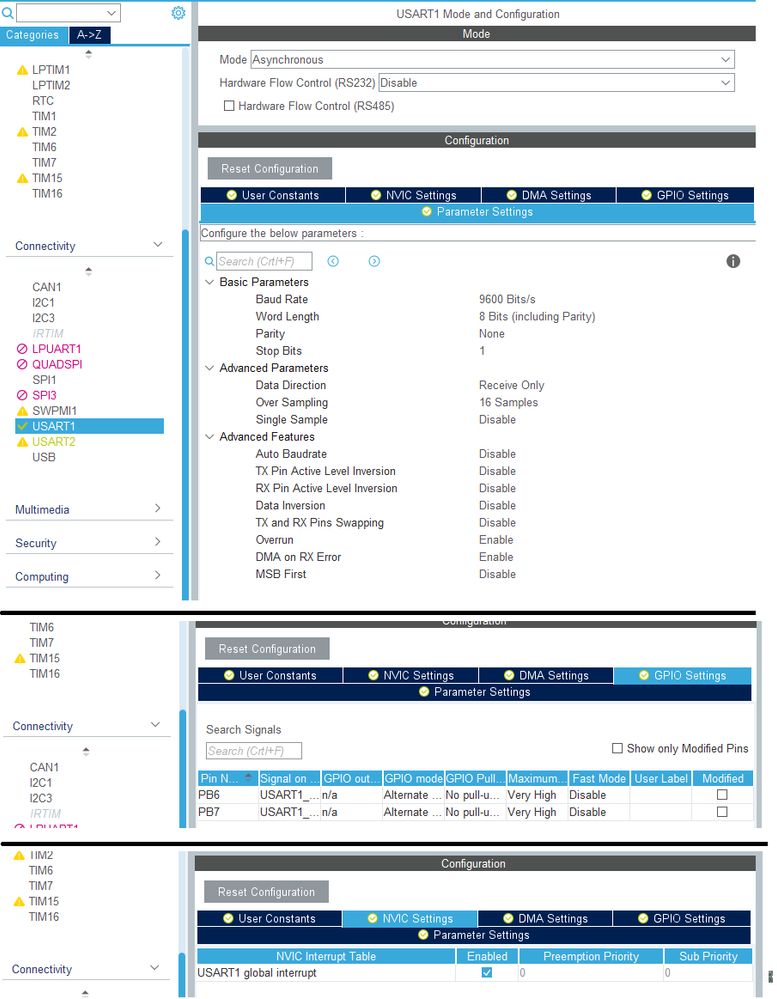

My UART configuration is here :

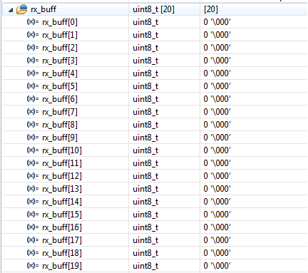

Then I compiled the code, and I expected to see parts of the data form the GPS in my rx_buff variable. But there is no data in this variable according to the "live expression" debugging tool.

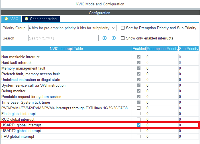

- Priority of UART interrupt is set to 0,0 (see screenshot)

‎2019-10-03 10:05 AM
When are you looking at the receive buffer? Are you looking immediately after calling HAL_UART_Receive_IT(), say by setting a breakpoint or single-stepping in the debugger? If so, there won't be anything there YET. You should add code to your HAL_UART_RxCplt_Callback() to set a global (and volatile) flag saying that you have received 20 bytes. Then in your main loop, wait for that flag to be set and THEN look at the receive buffer.
This should instruct Cube to generate NVIC enable interrupt call for the UART . Have you checked that it is generated and called?

- I'm looking at the receive buffer every time. The "live expression debug function" of STM32Cube IDE makes it possible to watch continuously variables. So I should see this buffer changing very fast. Instead it stays at 0.

Thanks for your help.
- I don't see generated NVIC interrupt call for the UART in the main.c. Should it be generated in main.c ? What does it looks like ?
