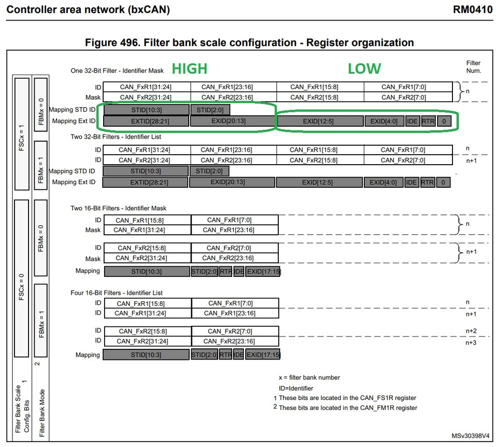

Once again I am struggling with CAN Filters for extended IDs using CAN2 on a STM32F765.
I have the ID 0x010100 and the filter should look like 0xXX0101XX where the X hex should be ignored.

>>Preferably as an explanation for a 5 year old so I don't have to ask again about filters.
Would suggest looking at the Picture/Diagram in the RM showing the relationship between the bits in the register and those on the wire you wish to identify. Randomly shifting won't get you to the answer, and as I recall the Extended ID spans more bits and probably not contiguous, as the two registers are 16-bit wide
The test is of the form (Bits in Register & FilterMask) == FilterID
Where the high order bit in the high order register is first over the wire

Hello again,
thank you @SofLit and @Tesla DeLorean for your quick responses.
I changed my filter mask to 0x00FFFF00 as mentioned and had a closer look at the diagram.
As I understand it now, this would be the correct way:
uint32_t filter_id = 0x010100;
uint32_t filter_mask = 0x00FFFF00;
can_addr_filter.FilterIdHigh = (filter_id >> 13) & 0xFFFF;
can_addr_filter.FilterIdLow = ((filter_id & 0x1FFF) << 3) & 0xFFFF;
can_addr_filter.FilterMaskIdHigh = (filter_mask >> 13) & 0xFFFF;
can_addr_filter.FilterMaskIdLow = ((filter_mask & 0x1FFF) << 3) & 0xFFFF;
It works and I have understood the filters! Thanks again!
