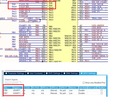

I am using the STM32U5A9J-DK for a UART communication test, and I expect to display the content sent from the computer's Serial port on the screen (textArea).
I'm using UART1, 115200 Baud rate, 8 data bits, 1 stop bits, and I've turned on the UART interrupt, but for some reason the text on the screen doesn't change.

Hello @jessie_chiu ,
you are sharing the IOC file and it seems like you are not using the correct pins for UART communication . the UART instance connected to VCP (virtual com port)of STlink is UART1 on pins PA8 and PA9. check you configuration to make sure you are using the correct pins and if you are using printf to display the text make sure you are correctly surcharging it .

As stated by @STea you're not assigning the correct IOs for UART1 to connect it to VCP:
So replace PB6 by PA9 and PB7 by PA10 in CubeMx.

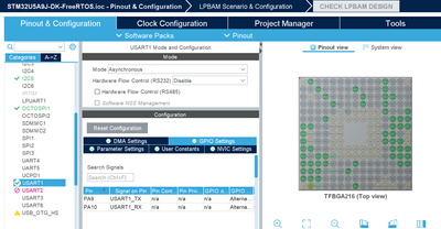

Thank you for your reply. I didn't notice the pin problem!!
But after I fixed the pin define, I still don't get the message.
Do you have any other suggestions?

hi @STea , I referenced the article you mentioned, thanks for your help.
This is what I found:
1. If I generate the project directly from cubeIDE, I can receive messages from the serial monitor.
2. if the project is generated by TouchGFX, using the same code will not work.
I'm not sure if this has anything to do with the FreeRTOS setup, hopefully someone can give me some experience with this. :folded_hands:
You didn't mention if you already succeeded with a simple code: no TouchGFX nor RTOS!
Did you try a simple project using UART? This is the first step you need to do at least to validate your HW+UART config.
Another thing to have in mind, check the conflicting resources between UART and the display/Touch screen pins: it could be a GPIO conflict between UART pins and the LCD/Touch screen pins you are using.
Sorry if I was not clear enough. I used the simple code from the article and got 1.
So HW+UART config is communicable.
In that case as I said try to find the conflicting ressources between TouchGFX and UART
