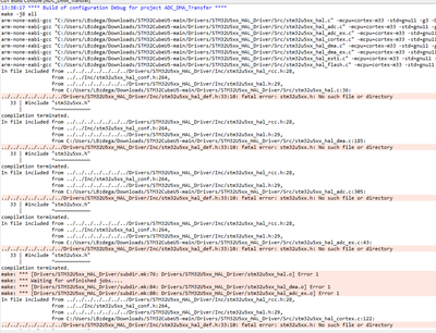

Can't get rid of the below error:
"make: *** No rule to make target 'C:/Users/LBzdega/Downloads/STM32CubeU5-main/Drivers/STM32U5xx_HAL_Driver/Src/stm32u5xx_hal.c', needed by 'Drivers/STM32U5xx_HAL_Driver/stm32u5xx_hal.o'. Stop."
Hello @aristot
Could you please verify whether the file stm32u5xx_hal.c exists in the following path: "C:/Users/LBzdega/Downloads/STM32CubeU5-main/Drivers/STM32U5xx_HAL_Driver/Src"
Additionally, please check your Makefile to ensure that the path to stm32u5xx_hal.c is specified correctly.
Saket_Om
In fact it was empty. For some reason Git didnt pull content of this directory.
Now have below issue:
I don't see anywhere the "stm32u5xx.h". There is only "stm32u5xx_hal.h"
Not sure where to fix this.
Hello @aristot
This repository has been created using the git submodule command. Please check the instructions below for proper use.
  1. To clone this repository along with the linked submodules, option --recursive has to be specified as shown below.
         git clone --recursive https://github.com/STMicroelectronics/STM32CubeU5.git
  1. To get the latest updates, in case this repository is already on your local machine, issue the following two commands (with this repository as the current working directory).
         git pull git submodule update --init --recursive
For more details please check the link below:
STM32CubeU5/README.md at main · STMicroelectronics/STM32CubeU5 · GitHub
The file "stm32u5xx.h" is under "STM32CubeU5\Drivers\CMSIS\Device\ST\STM32U5xx\Include"
