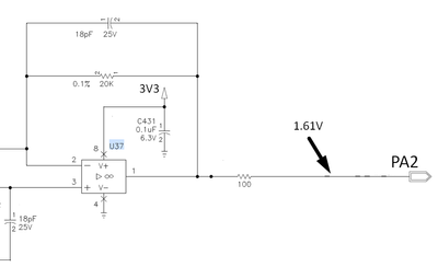

@aristot wrote:
assuming I have stable (verified with oscilloscope) voltage 1.61V.
Sure, we can assume that - but have you verified that it is actually true?
Have you measured directly at the MCU pins?
Sorry for being not clear.
Yes I veriffied it using the oscilloscope directly on MCU pins.
I also verify that VREF is stable.
You still haven't given any details of your hardware setup:
  • schematics, etc;
  • details of whatever is sourcing the signals to the ADCs
  • some good, clear photos may help...
Appologize but can't share a photo.
The sourcing is as on attached screen.
So I am driving it through 100ohm resistor using the OPA2325 opamp.

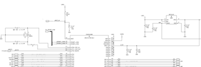

STM32 schematic ?

There is only one register to read the ADC value from and you are reading 4 channels that are stored in the same ADC register and you don't have a good synchronization (moreover using HAL_Delay()) in your implementation. This will completely introduce errors in the reading. Using DMA will manage that sequence automatically and it will fill your ADC_Data[] table with the correct values in their respective order.
Sorry for partial print but I can't share full schematic.
Perhaps start with converting a single channel and verifying it is working correctly before you move to multiple channels. Multiple channels will require the use of DMA.
