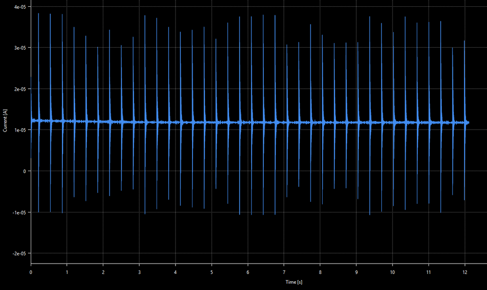

I am using an STM32U585 with STOP mode and FreeRTOS in tickless idle mode. The datasheet says the current consumption should be around 4.5uA, however I am measuring 35uA on my custom board that only has the MCU and some decoupling capacitators. Can someone tell me if I need to add something in the code to lower consumption? Are the datasheet consumptions possible running an RTOS? I will leave my code and measurements in attach:

To better isolate the source of the higher current consumption, could you please perform a first measurement in STOP2 mode without FreeRTOS enabled.

Hello, I have used this code to measure STOP2 mode in bare metal.

I got around 12uA. This is way better than using FreeRTOS, however its still far from the 4.5uA advertised in the datasheet. Do you have any hints?
BR.
Hello @JPortilha
Please refer to the article below which cover the needed steps to use the FreeRTOS™ in tickless mode, specifically entering in STOP2 low-power mode with the STM32U5.
How to use STM32U5 with FreeRTOS™ in tickless mode - STMicroelectronics Community

Hello, I have already done all that and I still don´t get the consumptions advertised in the datasheet. What else can I do?
