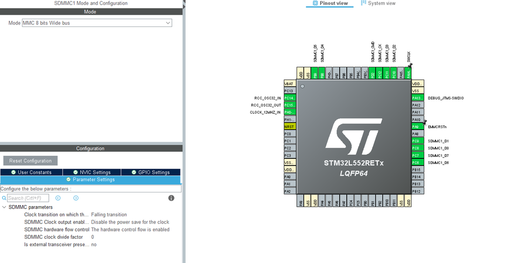

See the main file attached below. Additionally, here's a picture of the main .ioc configurations in question here:

Hello @DB.7arke​,
Can you provide me with your full main file?
I would like to check the SDMMC peripheral initialization.
