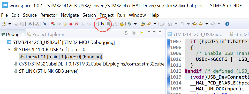

‎2019-07-20 3:03 PM
(picture courtesy of @SToma​ )
‎2019-07-21 2:43 PM
hi all.
thanks for the hint Jan, but when I do singel step, it works fine until I push resume.
So I can single step trough the whole thing and it is fine, but when I let the processor run freely again it ends up in HardFault.
So I am not any wiser from that unfortunately.

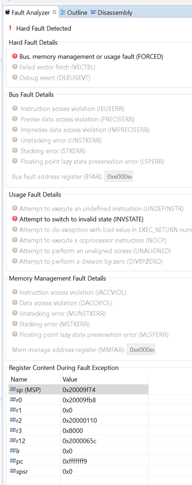

what I found in Truestudio was the problem window.
It reports an hard fault and gives some info, unfortunately I do not understand what it means.

‎2019-07-21 4:19 PM
My guess is, that the problem occurs in the USB interrupt service routine (ISR), and you have disabled interrupts during single-step (that's a common setting, otherwise it would be hard to single-step most practical programs).
You may perhaps want to place a breakpoint into the USB ISR and single-step from there to see, where that will take you.
Do you have a PC connected to the USB when the problem occurs?
