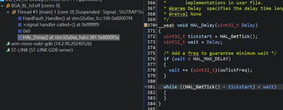

hi ,
i enable tamper4 and RTC in stm32mx and only enable bit RTC_CR_TAMPTS, TSE=0
no other code add into rtc.c or tamper.c
Using debug mode to clear TSF and CTAMP4F.
when push button will happen hard fault.
Only two code in main while loop "led" and "hal_delay", if i remove HAL_Delay , will not happen .
someone can help me?
HAL_Delay(1000);
HAL_GPIO_TogglePin(GPIOA,GPIO_PIN_11);
Solved! Go to Solution.

‎2025-06-02 1:00 AM
hi Saket_Om,
Try disable WWDG, but still happened.
I follow how to debug to trace hard fault cause by "HAL_Delay".
Now use TIM to replace HAL_Delay. It seems work good.

Hello @russell_hsiao
Could you check without WWDG init please?
Saket_Om
‎2025-06-02 1:00 AM
hi Saket_Om,
