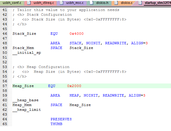

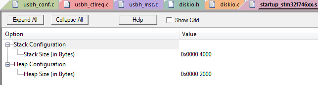

For Keil, makes sure you have an adequate stack allo​cation in startup_stm32xxxx.s

Stack Allo​cation in startup_stm32746xx.s as below:

Stack/Heap look plenty large. On the F7 I'd recommend using the DTCMRAM when using DMA, otherwise you'll need to manage the cache-coherency more explicitly
