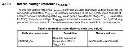

I am trying to read multiple ADC channels using the Stm32l072 microcontroller. As we know VREFINT_CAL is the VREFINT calibration value.but , I noticed that this value is not in the reference manual.(There is no memory adress.Is it a problem ?)

VREFINT is an internal voltage. It is not exposed anywhere so I'm not sure how you could be measuring it. In any case, it should be around 1.2 V, but there is no "VREFINT" pin.
VREFINT_CAL is a calibration value taken of the VREFINT channel during production. The address this is stored is in the datasheet.

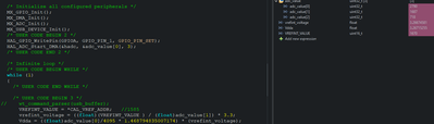

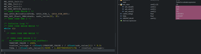

‎2024-08-05 7:52 AM
The difference between the two images shows the result obtained after taking the vrefint_cal value from the register or giving the appropriate reference value. While we should see 3.09V as a result of the vrefint_cal value coming from the register, we see 3.29V as seen in the image. If the reference value is 1585, there is less than %1 difference between the value shown by the battery and the value we measure.
Considering this situation, is it the right step to change the vref_cal value manually rather than in the register?
‎2024-08-05 2:07 PM
The math doesn't make a whole lot of sense. Use the VBAT channel to estimate VBAT, but you have to know your VREF+ voltage to do this.
You can use VREFINT to estimate what VREF+ is. Is that what you are trying to do? If you already know VREF+, there is no need to use this channel for anything except to sanity check the voltage, which should be around 1.2 V.
