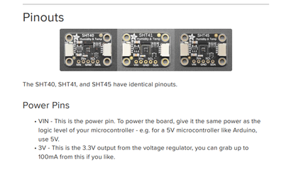

ABans.3
I think you are powering the board wrongly. The as per the doument below vin in should be used for powering the board, not the Vo which is meant to be voltage output. Thanks
https://cdn-learn.adafruit.com/downloads/pdf/adafruit-sht40-temperature-humidity-sensor.pdf
Best Regards
Ankit  Bansal

Sure this could have been an issue but for now I have removed the SHT40 from the equation as there seems to be issue with the i2c itself. Please look at my initial post update. The i2c seems to be missing clock cycles.
