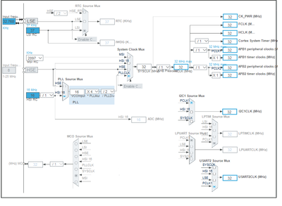

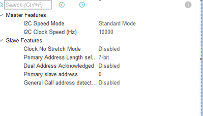

2023-09-18 2:09 AM
Yes. I have connected 22kOhm pull-up resistors to both SCL/SDA pins.

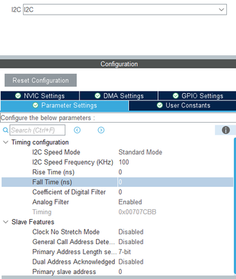

Perhaps there is an issue with my I2C config:
I dont recall that I had to manually set Rise and Fall time parameters. I have tested the I2C on the stm32f407 and that microcontroller does not even have such options:
Also, Could there be an issue with my clock settings:
And yes, I have also tried to wire it to other SCL/SDA pins but the results are identical.

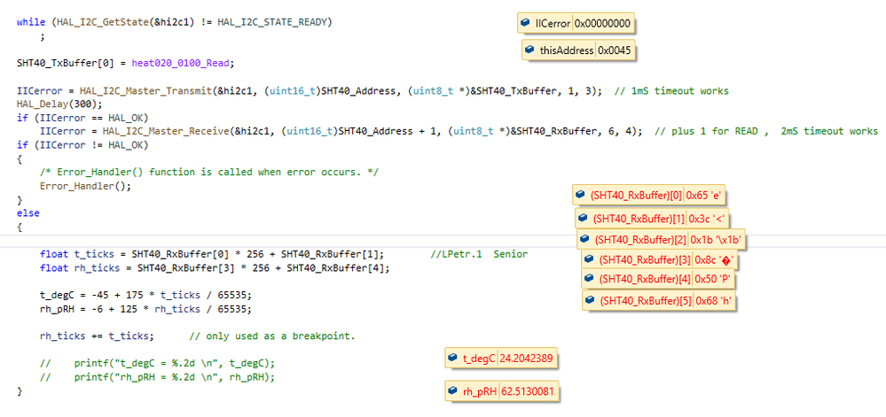

2024-12-18 1:17 PM - edited 2024-12-18 1:19 PM
I have the same STM32C031 running a SHT40 on this new prototype. (Now running correctly)
The code is Cube assisted and running on Visual Studio.
I have the Vcc at 2.2v and had a similar issue.
I was getting nothing on the IIC pins on the scope.
In the cube, I had to enable pullups on those pins and maximum output speed set to Very Fast, then it all started working on the scope.
I have 10k pullups on the PCB, but checking the prototype, these parts were not installed :( my bad.
Now I can see it running on the scope
The other issue I had was the processor clocking rate.
To save power I run SysClock at 750KHz, (The HSI-48 clock is divided by 64)
To fix the issue caused by this, I found the IIC timing configuration needed adjusting.
The cube suggested for 100KHz operation, the Timing configuration value 0x00000002, which didn't work,
I incremented and tested values 3,4,5,6,7,8,9,a,b,c manually in main,c, found 9,a,b,c all worked ok.
Adjusted the cube to run the IIC at 48KHz producing a timing config of 0x0000000A and it all runs sweet.
But then, the address is different for these chips, SHT40 can be address 0x44,0x45,0x46.
I had to run a check on the actual SHT40 address and found this one responds to 0x45 addressing.
