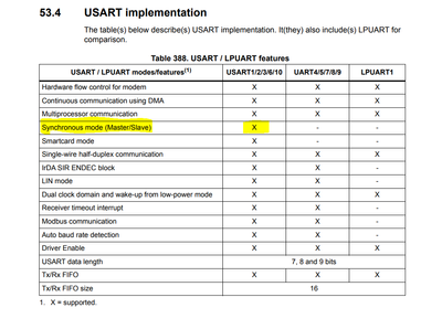

I wonder if it is possible to set up the STM32H7B3 µC as a synchronous usart slave with the usart1 peripheral. From the reference manual it seems that it is only possible to set it up in 'SPI-mode'. The functionality I want is a USART slave that transmits data packets at a fixed rate(i.e. 1kHz) with no NSS, at the bit-rate determined by a continuous clock provided by the master.

Synchronous slave mode is fully supported on USART1 of the STM32H7B3 MCU. For further details, please refer to Section 53.4 in the Reference Manual RM0455, as indicated in the table below.
You can refer to this example which describes an USART-SPI communication (transmit/receive) between two boards where the USART is configured as a slave.

I was a bit inaccurate in my post. My needs are maybe atypical, but I'm trying to implement an asynchronous communication protocol that communicates at a frequency determined by a continuous input clock. For the SPI slave mode, there are timing requirements (time between chip select edge and first clock edge) that appear to not be compatible with my requirements of an continuous clock at the input.
I suspect that this somewhat unusual functionality is not supported by st libraries.
