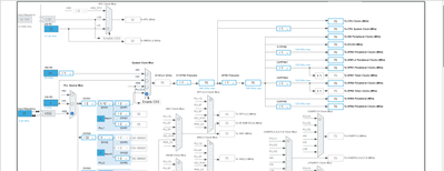

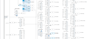

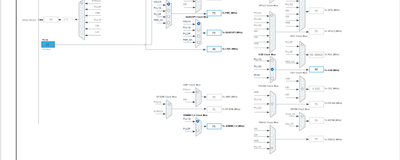

i am now able to access eMMC through OTG fs but it taking time to detect (almost 5-10 sec). does eMMC has to take that much time to detect ??
i have set
mode :8 bit
prescalar :50
clock settings:
and also i have make touchgfx ui which has shapes but it does not show it .
is it because of inappropriate clock configuration??
FBL
Hi @Prajyot1
indeed, SDMMC peripheral clock and prescaler affects the SDMMC clock speed. Slower clock means slower initialization and data transfer. If you have debug prints, check the time spent in eMMC initialization and FatFS mount. Try lowering the prescaler value to speed up data transfer.
TouchGFX relies on LCD-TFT Controller Clock.
  • Verify that the LTDC clock source and prescaler are set correctly according to your display specs.
  • Make sure the framebuffer is properly allocated and accessible.
  • Ensure DMA is enabled and cache coherency is maintained.
Best regards,
FBL
