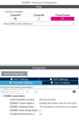

I wonder how to approach it in my TouchGFX application / STM32CubeIDE. There is a full board configuration I have to work with. It would be the best if I could just follow the CubeMX guide part of AN5200, but it doesn't work at all. When I select SDMMC1 configuration as MMC 8-bit (as it should be and seems best considering the chip used and internal connections) - the SD option is unavailable in FATFS middleware settings. There is no option for MMC, though it can be manually set up in code.
I was able to configure FATFS myself, however, the driver I was able to run seemed not to use DMA at all , that seems to be at least strange. What's more - I honestly don't know how to configure the DMA for the eMMC manually, STM32CubeIDE usually does that perfectly, however - there is no such option here, unless I switch SDMMC1 configuration to work in SD 4bit mode.
So, using SDMMC1 configured as 8-bit MMC doesn't work. BTW, I tried 50MHz and 25MHz clock speeds. The chip initialization passes, it is detected and powered. Then, when the first data transfer occurs I get random buffer underrun errors, that are quite expected since the DMA is not even used.
Now I'm a little lost about what to do next. In order for FATFS work, AFAIK I need provide just a few functions that read and write blocks. I can implement them myself. I wonder why the ones provided by ST (HAL) don't work. I also don't know how can I configure DMA for the eMMC either using CubeIDE or manually.
UPDATE:

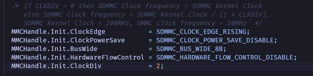

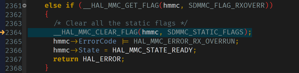

I was able to configure MDMA as described in AN5200. Now when I run MX_SDMMC1_MMC_Init() it fails with HAL_MMC_ERROR_RX_OVERRUN error:0693W00000Sw5klQAB.pngWhy is that? The clock that gets into eMMC (MTFC4GACAJCN-1M WT chip) is 25MHz. hmmc1.Init.ClockDiv = 2.
Somewhere else I read it's crucial the clock frequency must be set pretty precisely in order for it to work, however, in MTFC4GACAJCN-1M WT it's stated that the chip accepts up to 50MHz frequency. Why is the ClockDiv? According to the eMMC chip documentation, I should be able to read it up to its top speed, 50MHz, ClockDiv = 0, however - it definitely doesn't work. The first read fails. Using lower speeds makes some read operations succeed, but later on - eventually always a buffer underrun or buffer overrun occurs.

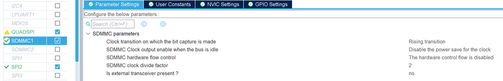

UPDATE:

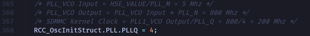

Now I'm trying to recreate the example:

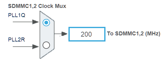

0693W00000Sw5qZQAR.pngSo, the SDMMC Kernel Clock is 200:

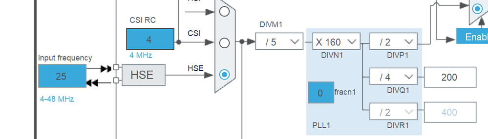

0693W00000Sw5qyQAB.pngThen:
0693W00000Sw5rNQAR.pngSo:
0693W00000Sw5rSQAR.pngStill - the same error, same line.

OK, I've solved the case.
Here are steps to make it work:
  1. Configure SDMMC1 to use 8-bit bus, 50MHz clock after division (in my case - 200MHz clock, divider is 2).
  2. Configure FATFS middleware for any device, MMC is not available, USER option can be selected. The key part is to check all the option allowing to use long file names and UTF, optionally exFAT. I just added MMC binding manually, without USER option.
  3. Configure MDMA for SDMMC1 transfers. I just added all available, IDK if it's necessary.
  4. Get the diskio.c template for DMA / RTOS from https://github.com/STMicroelectronics/STM32CubeH7/blob/master/Middlewares/Third_Party/FatFs/src/drivers/sd_diskio_dma_rtos_template_bspv2.c
  5. REPLACE ALL BSP API functions with HAL functions, paying close attention to different return values for BSP and HAL API.
  6. Done. It works.
Of course it's valid only when using RTOS, that is a default option for TouchGFX and that board. The FatFS functions are available when RTOS kernel is running, I mount the eMMC FS in RTOS task. I mounted actually 2 file systems, to access the files I need to provide full path, like "0:/file.dat" or "1:/file.dat", because when I used the file name alone it looked for it on wrong file system (USB disk that was not present at the time).
Parts I missed that costed me over 100 hours of banging my head against the wall:
  1. Check if I use the I/O function on the right handle.
  2. Use only DMA transfers, polling mode fails miserably.
  3. Check what HAL_MMC_GetCardState() function returns.
  4. Check if BSP_MMC_ReadCpltCallback() and BSP_MMC_WriteCpltCallback() functions are called. They should be implemented and awaited after I/O.
When f_mount() or f_mkfs() is called, the first function in the driver that is called is MMC_initialize(). The template has DISABLE_MMC_INIT macro to skip internal initialization. That is crucial when the SDMMC1 is already initialized in main(). This macro MUST be defined. On MMC_initialize() only HAL_MMC_GetCardState() should be called.

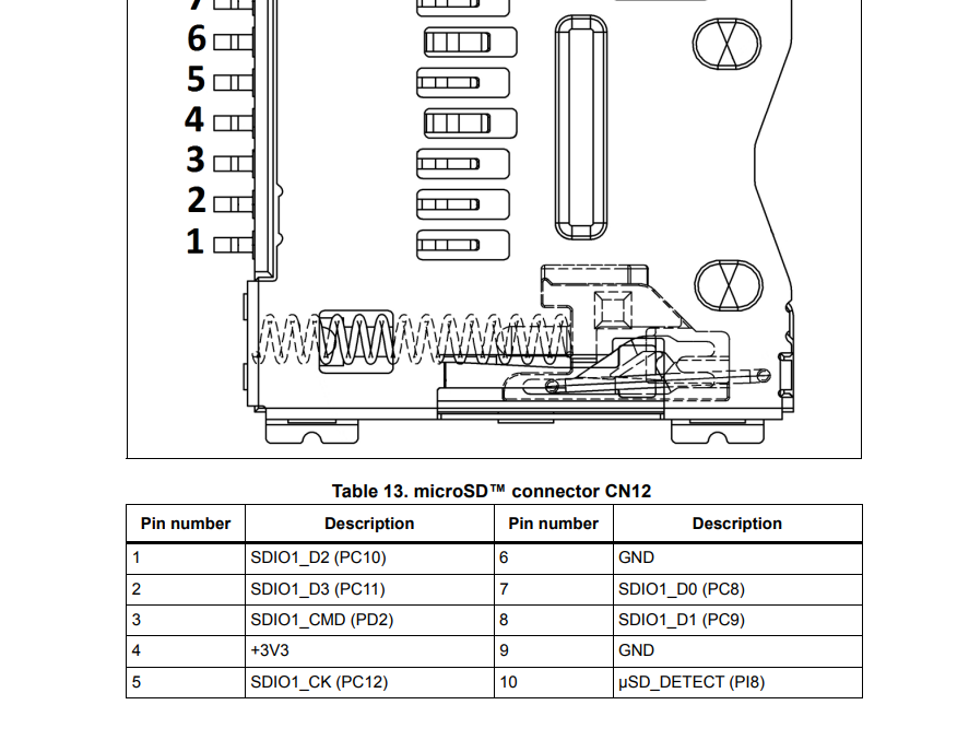

Hi @HTD , on my STM32H747I-DISCO board, I see only mode 4 wire. image.pngSo when I configured it as MMC 4-wire, I always take the FR_DISK_ERR error code when call f_write(). Could you give me suggest?
