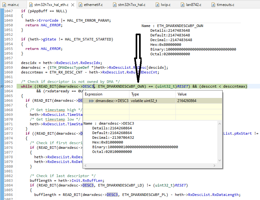

Hello!
I am trying to run ping on my board with STM32H745 (similar to NUCLEO-H745ZI-Q). Instead of the standard LAN8742, I have to use KSZ8081RNA. On the advice of @Piranha​ and @Pavel A.​ in other branches, I leave almost everything as it is in the LAN8742.c driver, I change only some registers in order for initialization to be successful (I only needed to change the LAN8742_GetLinkState function). I can read and write KSZ8081RNA registers. I see in debugging a link change when connecting/disconnecting an ethernet cable.
But ping data packets (ICMP) are still not coming to me.
The program does not pass /* Check if descriptor is not owned by DMA */ check (HAL_ETH_Read Data in the file stm32h7xx_hal_et.c line 1063) due to the values of the descriptors heth->RxDescList.RxDesc. It is equal to 0x81000000. In another, working project, it is equal to 0x3401003С.
0693W00000NqMBCQA3.pngMost likely, I did not fully initialize correctly, because the same project worked on NUCLEO-H745ZI-Q before the changes. I don't fully understand how packets are received via DMA. But what should I change except LAN8742_Init function?

I don't have STM32H745 but 0x81000000 does not look like a valid internal RAM address.
0x340100xx is a valid address.
Piranha
Principal III
May 20, 2022 11:30 PM UTC
RDES3 is not a memory address, but just a configuration word. 0x81000000 is an OWN and BUF1V bits, which seems to be OK.

Thank you all for your help! it turned out that everything was fine with the code, there was a solder defect with CRS_DV pin. At least we now know one of the symptoms of such a problem. I attach my project if someone needs it.
