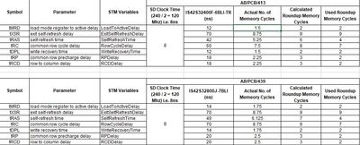

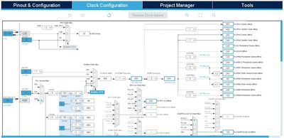

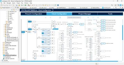

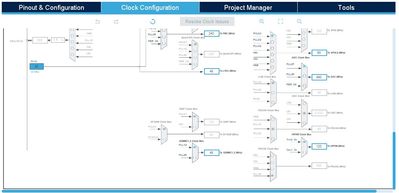

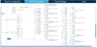

2024-08-02 11:36 PM
Please find the clock tree and the calculated timing diagram.
I will check the clock from 8 cycles to 9 cycles for 75nS self refresh time.
Is there anything need to change to resolve the issue?
Regards,
Alpesh
2024-08-03 12:45 AM
It's not my job to fix your board, someone is paying you to do it.
As I already said, review ALL your memory timing for errors.
- Please post an update with details once you've solved your issue. Your experience may help others.
