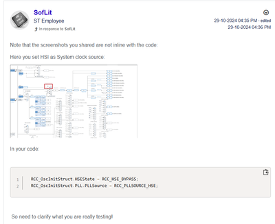

I have problems about configure my STM32H743VIT SysClock.
On my own PCB, i have a Crystal with 8 MHZ, and a LSE of 32.768 khz.
Settings are in my Screenshots, now if i debug my application, it ends in a Error Handler.. but why?
BTW: UART4,5,7 and USART1,2 enabled, and USB_DEVICE + USB_HOST is enabled.
Error_Handler(); /** JUMPS TO ERROR_HANDLER **/
my complete SystemClockConfig:

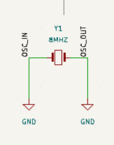

Sorry for my confusion, the day is long...
i have only a crystal on my pcb with 2 pins (not a crystal oscillator, with 3.3V supply), the crystal swings with 7.99997 MHZ on my oscilloscope.
i check my schematic, and i found a big problem, i have a crystal with 8mhz on 2 pins, but i forgot the decoupling condensators on the side to ground... :(
i think, that was the problem..?

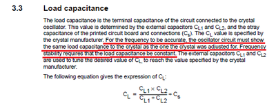

Sorry I didn't undrstand, but you got the oscillation and 7.99997MHz is a good value. What's the problem then?
I don't think CL could induce the described issue at the beginning.
The CL are responsible to fine tune the frequency of the crystal:
From AN2867 "Guidelines for oscillator design on STM8AF/AL/S and STM32 MCUs/MPUs":
And you still didn't answer my question regarding what the exact config you are really using?
Please answer the question from my previous comment:
Bypass or not? you should not use Bypass in your case as you are using a Crystal.

1- Did you solder CL load capacitors?
2- Please attach your ioc file.

@Sany wrote:i dont understand the problem, why the error is HAL_TIMEOUT.
It's waiting for the HSE to become ready - that is taking too long, so you get a timeout.
So look at what might prevent the HSE from starting; eg, shorting both OSC_IN and OSC_out to ground would be a pretty effective way:
‎2024-10-30 2:51 AM
‎2024-10-30 2:56 AM
@Sany wrote:i check my schematic, and i found a big problem, i have a crystal with 8mhz on 2 pins, but i forgot the decoupling condensators on the side to ground... :(
It's worse than that!
Both sides of the crystal are shorted to ground!
@Sany wrote:i think, that was the problem..?
Yep - which shows why it's important to post the schematic!

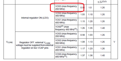

‎2024-10-30 3:02 AM - edited ‎2024-10-30 3:05 AM
Just a question: your system clock is set to 75MHz, and the VOS is set to VOS2 while it needs to be set to VOS3:
Did you set it manually or it was set automatically by CubeMx?
‎2024-10-30 4:48 AM
Hey,
I enabled only the HSE and LSE and changed my system clock to 160 MHZ in CubeMX.
After i disabled my wrong soldered HSE, the system clock is changed to 75mhz after i clicked "resolve clock issues"
CubeMX sets automatically the VOS2, i changed the VOS2 now to VOS3 manually.
i created a new project, and CubeMX sets VOS to VOS0 and Product Revision to "Y". When i change the Product Revision to "V" then sets CubeMX VOS2.
That's a good hint, i wouldn't have noticed it, because my code runs, after disabling the HSE.
here is my corrected config, with VOS3, 160mhz, and disabled HSE.

Hello @Sany ,
your attached ioc file is setting the system clock to 64Mhz with HSI.
I'm very confused. We need to converge.
So to conclude: if you have
Rev Y: Max system clock is 400MHz at VOS1.
Rev V: Max system clock is 480MHz at VOS0.
I'm attaching your ioc file with some modifications I did to set the crystal at 8MHz and system clock at 400MHz at VOS1 (this is working on rev Y and Rev V) / with:
