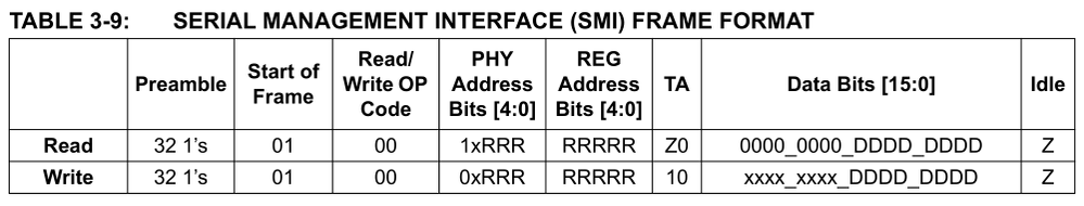

I am trying to use the KSZ8863 IC and (as shown in Table 3-9 of its datasheet) it has many configuration options behind a tweaked version of the standard MIIM interface. In particular, the opcode needs to be set to 00.
I have tried the following:
- directly modify ETH->MACMDIOAR directly to set the PA and RDA bits as required by the KSZ8863 Table 3-9 (instead of HAL_ETH_ReadPHYRegister)
- set MACMDIODR to 0
- set the C45E bit of MACMDIOAR (I am not sure about this and if that makes sense for this PHY, but RM0433 says "When Clause 22 PHY is enabled, only Write and Read commands are valid.")
- Set the GOC bits of MACMDIOAR to 00 (despite it being "reserved" according to RM0433)
This results in a garbage reading. I don't at present have a way to probe the MDIO physical line, so any advice about if this should be possible, and other register settings to try, would be very helpful.

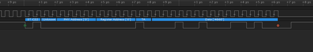

This results in the following transmission on the wire: note that OP=00 despite it being listed as "reserved" in the RM, with the desired ST=01. I am just sending (bogus) data 0x1234 to register 0 as an example. EDIT: I have also verified that the write is accepted by the device.

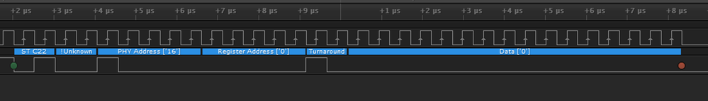

The bad news is that the custom read instruction does not work. Here is an example where I have done everything as in the write, but also cleared DR, and asserted the high bit of PA:
You can see that the everything till the turnaround is correct, but the data is 0. I assume this is because the STM32 is driving the MDIO line since it does not know that this is a read command, and the device (KSZ8863) cannot drive it.
I cannot find any other (documented) bits in ETH_MACMDIOAR that could possibly affect this behaviors so at this point I am being forced to give up on this and assume bit-banging is the only way this peripheral could be used for this protocol. For ST engineers: it would be great if there could be just a tiny bit more flexibility in this peripheral (perhaps one of the reserved bits of ETH_MACMDIOAR could be used to explicitly signal if the data line should be driven or Hi-Z).

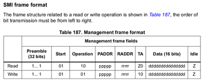

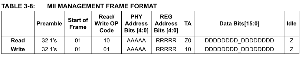

Except for the op code (which seems to suggest using the clause 45 bit), I notice that the protocol calls for "01" for the "start of frame" as shown in these tables (first regular MIIM, then the modified SMI)
However, it seems like the "start of frame" for clause 45 mode is 00 https://www.totalphase.com/support/articles/200349206-MDIO-Background
I have also looked at this other post https://community.st.com/s/question/0D50X00009XkgMuSAJ/stm32f7-clause-45-mdio where the suggested solution was bit-banging, but it is also true that the clause 45 bit appears to be new in this H7 compared to the chip referenced in that post.
