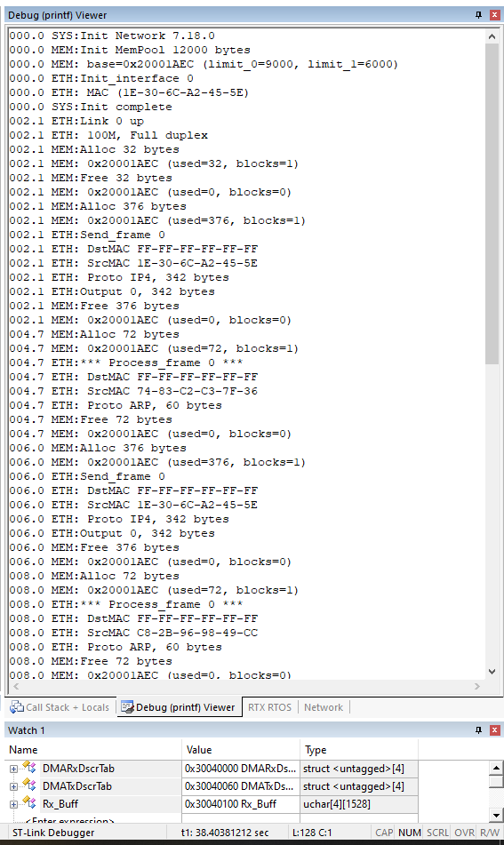

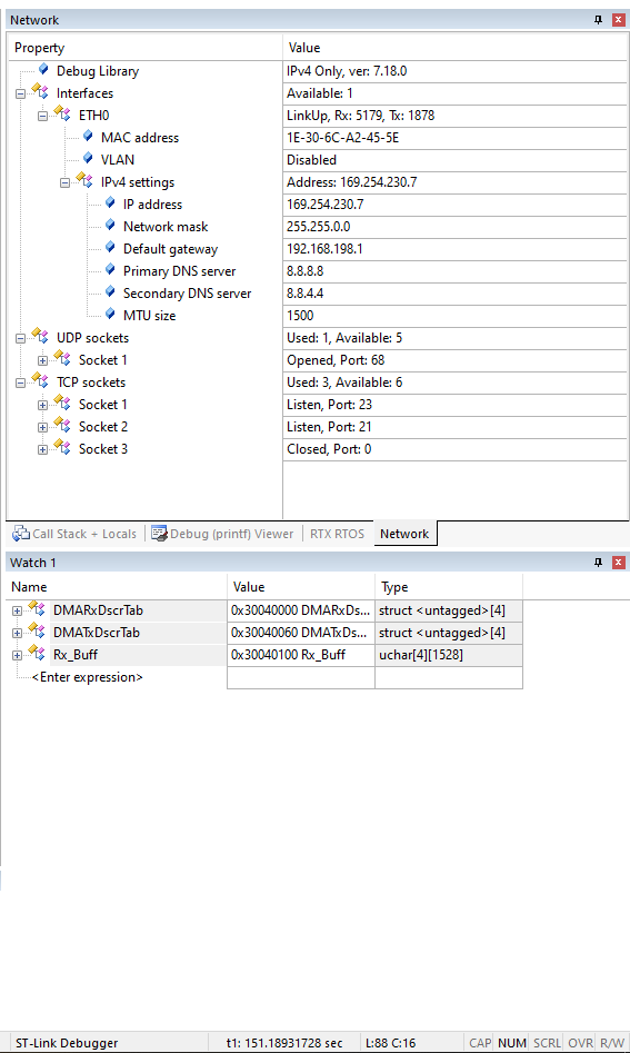

Got a problem with ethernet on my custom board with STM32H743BIT and DP83848 PHY
everything 'seems' to work, but I see no outgoing traffic from my board on wireshark.
Rx working though, screenshots attached.
I read an article
https://community.st.com/s/article/FAQ-Ethernet-not-working-on-STM32H7x3
but it didnt help.

Did you try the latest release of STM32CubeH7 (version 1.11.0)?
Please check this post: How to make Ethernet and lwIP working on STM32, it may help you as contains the most Ethernet issues that are already fixed or follow-up action is ongoing.
Imen
Thanks
Imen
Piranha
Chief II
If just the Tx is not working, it could be this issue:
https://community.st.com/s/question/0D53W00001oImr4SAC/bug-stm32-lwip-ethernet-driver-tx-deadlock
Or anything from my other topic, to which Imen gave the link already...
AlexSmart
Senior
Well, it might be it. I switched to Oryx Cyclone stack and it works perfectly
